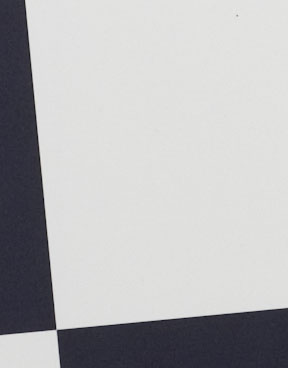

    We are using so-called “slanted-edge MTF measurements” to analyze the resolution of a lens. If you are interested in the background information, take a look at https://www.imatest.com/docs/mtf-measurement-consistency/. We are using Imatest as our primary test tool.
    Lens performance measurement chart — 3:2 frame, border markers shifted inwardA 3:2 image frame with 11 circular measurement markers. Border markers are shifted further inward along the diagonal axes by one corner marker diameter (30px).3:2 frame — 11 measurement positions
    What you can also conclude from this – regardless how accurate we try to be, there’s always a certain error margin. We also provide the LW/PH values (Line-Width per Picture-Height) besides the performance charts. The LW/PH figures are roughly related to the vertical image resolution of a sensor.
    e.g. if a sensor has a resolution of 6000×4000 px (=24 megapixels), the maximum LW/PH could be 4000. We tune our testing parameters so that the peak performance is roughly within 10% of this figure (e.g. 3600 in this example).
    It also explains why the reviews are NOT cross-system comparable because different sensors have different resolutions and also different characteristics. So don’t use the numbers to compare -say- a Fuji review with a Nikon review. We are actually not overly happy to provide the LW/PH figures because of the mentioned error margin as well as the temptation of users to use the numbers to compare lenses between systems. At some point we removed the LW/PH figures, but this resulted in a storm of protests … so reluctantly we reverted this decision. Anyway … we suggest that you only take the “interpreted” ratings as guidance.
    Also – nobody is perfect, and neither are we. We strive to provide the most accurate results, but we do also encourage you to cross-check our findings with other test sites.
