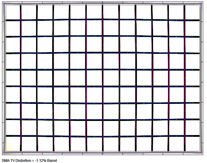

Unlike most MFT lenses, the Kowa Prominar series is fully corrected - thus it doesn't rely on image auto-correction. The latter is also not possible due to the lack of EXIF information anyway. As usual Kowa did a good job in terms of distortion. The Prominar 12mm f/1.8 shows a barrel distortion of 1.1% which is low for such a lens even by DSLR standards.

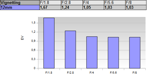

The vignetting is a weakness of the lens. A light falloff of 1.6EV (f-stops) at f/1.8 is clearly visible. Stopping down helps a bit but not quite as much as you would have hoped for (minimum 1EV).

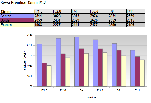

In terms of resolution we have a mixed beast here. Technically the lens is capable of delivering a sharp center even at f/1.8 whereas the outer image region is Okay. However, this is not the complete story here because field curvature is spoiling the game at this setting. If you are taking pictures of flat objects at large aperture settings, the corners will be extremely soft. This improves when stopping down but it remains an issue at f/2.8, a bit less so beyond. The peak performance is reached between f/4 and f/5.6 where even the corners are very good. Diffraction has a higher impact from f/11.

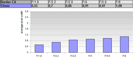

Lateral CAs (color shadows at harsh contrast transitions) are quite well controlled. They are barely visible at f/1.8 but increase when stopping down. However, even at f/8 they aren't really an issue with an average width of 1px at the image borders.
The Kowa Prominar MFT 12mm f/1.8 is the weakest offering in the Kowa lineup. The pure MTFs are actually quite decent. The center is always sharp at the mainstream settings and the outer image region is relatively decent at f/1.8, good at f/2.8 and very good between f/4 and f/8. However, field curvature is a major issue at large apertures so in the real life the results are less convincing here - at least in our sample which wasn't really well centered. Typical for the three initial Prominar lenses, both the distortion as well as the lateral CAs are low which is good because image auto-correction isn't possible. The amount of vignetting is generally on the high side though.
