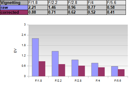

In the Zeiss Batis 85mm f/1.8 review we were somewhat concerned by the very high vignetting - a Zeiss trademark. The Sony FE 85mm f/1.8 isn't great either in this respect but it does a better job nonetheless. The RAW vignetting is clearly visible with a light falloff of 2.2EV (f-stops) at fully-open aperture. Stopping down to f/2.2 reduces that quite a bit but it takes f/2.8 to push it below the 1EV (f-stop) mark. If you use image auto-correction, the vignetting is reduced by 1.3EV to ~0.9EV (f-stops) at f/1.8 (thus the image noise increases accordingly) which is quite acceptable.
