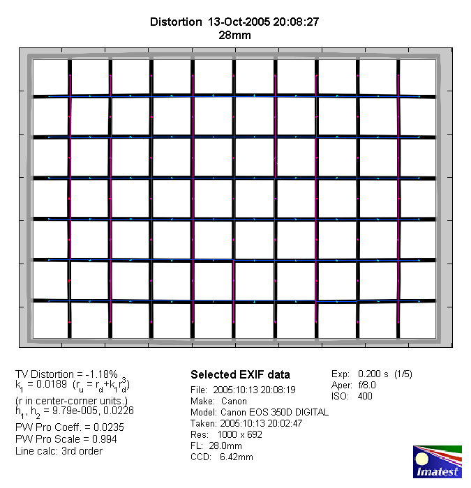

The lens showed a slight to moderate degree of barrel distortion (1.2%). Not stellar but
pretty good.

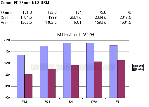

Similar to the Sigma AF 30mm f/1.4 EX the Canon lens showed a rather mixed behavior
in the lab. The center performance is already high straight from the max. aperture
setting peaking in exceptional resolution figures around f/4. Unfortunately the border
resolution lacks quite a bit behind. At f/1.8 the borders are very soft. Stopping
down help to gradually improve the resolution but even at f/8 the quality does merely
exceed very good values. At f/1.8 the lens also suffers from low contrast.
This is slightly disappointing for a modern fix-focal lens.

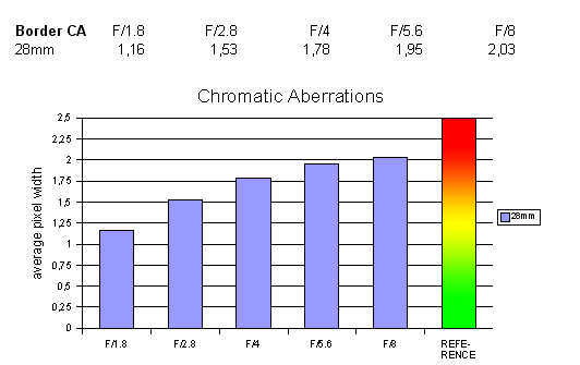

CAs (visible as color shadows at harsh contrast transitions) can reach an average CA pixel width
of more than 2 pixels at the image borders - a very weak performance here. CAs can be reduced
and usually even eliminated via imaging tools but a fix-focals should definitely perform better
than that.
