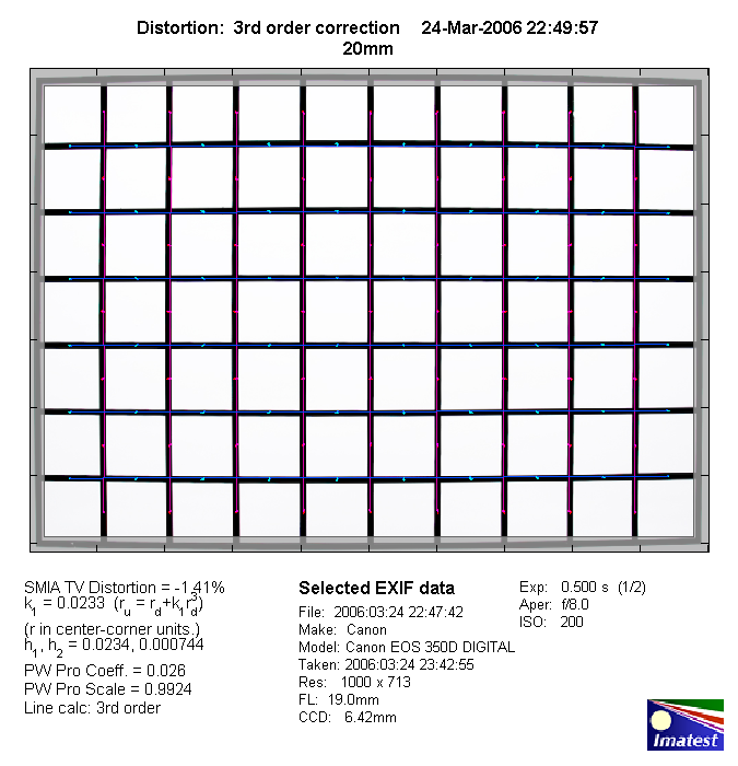

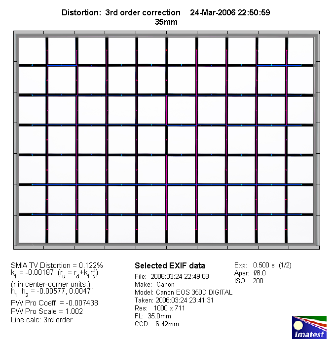

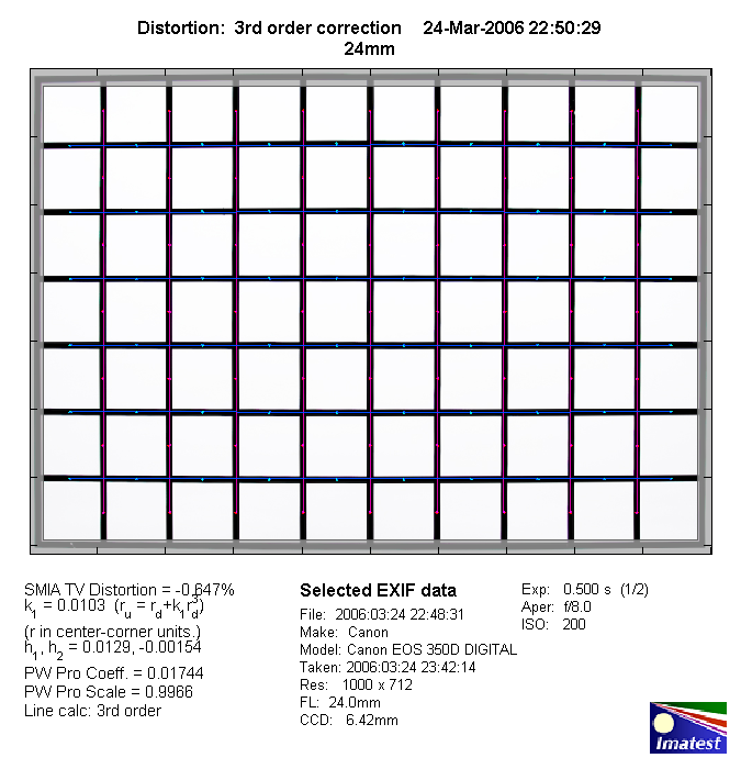

As usual this ultra-wide zoom lens shows some very strong barrel
distortion at 17mm easing towards the long end (35mm) where the
lens is basically free of distortion.
17mm:
20m:
24mm:
35mm:
You should probably expect more distortions towards closer focus distances.

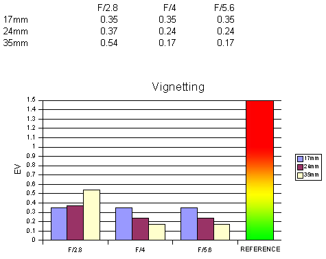

The EF 17-35mm f/2.8 USM L showed a very unusual vignetting characteristic.
On an APS-C DSLR it can take advantage of a sweet spot behavior
but at 17mm the lens already showed an optimal behavior with no measurable
improvement when stopping down (yes, I repeated the test row to make sure).
Due to the decreasing natural vignetting there's a little less shading
at 24mm. At 35mm the issue is marginally more pronounced at f/2.8 but negligible
beyond.

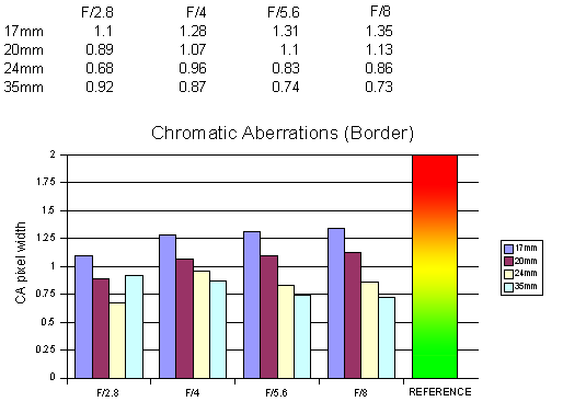

Imatest Explanations
Typical for most ultra-wide zoom lenses CAs (color shadows at harsh contrast transitions)
are quite pronounced with this lens but they remain in line with what we've seen from
similar lenses. As usual the issue is decreases towards the long end of the (ultra-wide)
zoom range.
