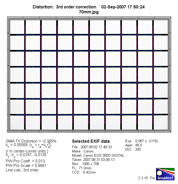

The level of distortion is very low throughout the zoom range and not field-relevant.
70mm 200mm 300mm

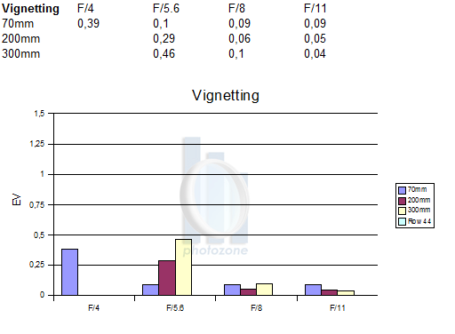

The Zeiss is a full format lens and it shows only a very low degree of vignetting (< 0.5EV) at wide-open aperture (APS-C DSLR). This is usually negligible under field conditions.

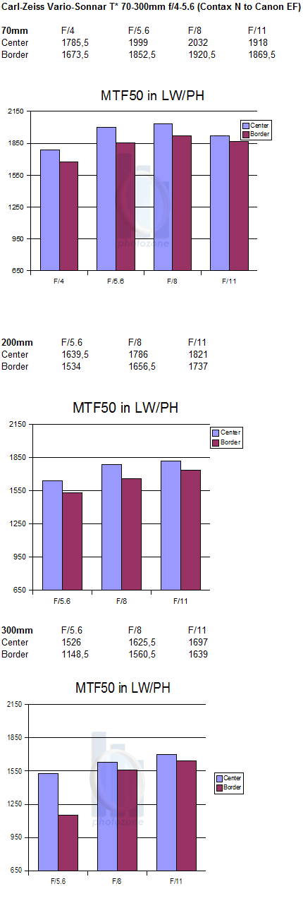

The MTF characteristic of the Zeiss lens is a bit of a mixed bag. At 70mm the resolution is on a very high level but the quality decreases continuously towards longer focal lengths. At 200mm the resolution is still very good but there're a more pronounced drop at 300mm @ f/5.6 specifically at the image borders (rather soft). At f/8 and f/11 the quality recovers to very good levels across the frame.

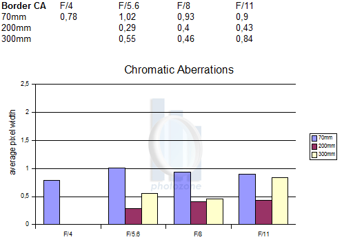

Chromatic aberrations (color shadows at harsh contrast transitions) are generally moderate with an average CA pixel width between 0.3-1px at the image borders. The tested sample showed a slightly uneven CA distribution.
