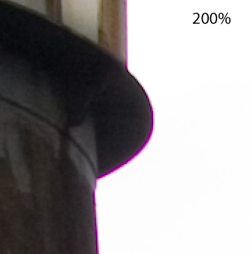

This is clearly the weakest characteristic of the AF 18-50mm f/2.8EX - CAs (red/blue color shadows at harsh
contrast transitions) are very high peaking in an average pixel width beyond 2 pixels @ 18mm.
However, they're also quite strong occurrences throughout the rest of the range. CAs are quite easily correctable
(e.g. via Raw Shooter Essentials or Photoshop ACR) but if you prefer straight JPEGs or don't want to bother
with post-processing the issue will be quite noticeable in some scenes. Have a look at the enlarged sample
portion (200%) to the RIGHT below.
It should also be mentioned that the lens exhibits also a fairly severe degree of purple fringing
at large aperture settings which cannot be completely reduced during post processing. Unlike "normal"
CAs purple fringing resembles diffuse halos which pollute into darker areas (see the image to the LEFT below).
Stopping down helps to reduce fringing.
