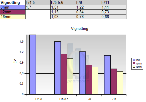

Ultra-wide lenses suffer from a given amount of "natural vignetting" (cos4 law of illumination falloff) so it's no surprise that the vignetting figures show worse results than usual here. The light fall off is worst at 8mm @ f/4.5, of course, and it's advisable to stop down to f/8 to tame the problem to an acceptable degree. The problem isn't as pronounced at other focal lengths but it makes sense to close the aperture a little here as well.
