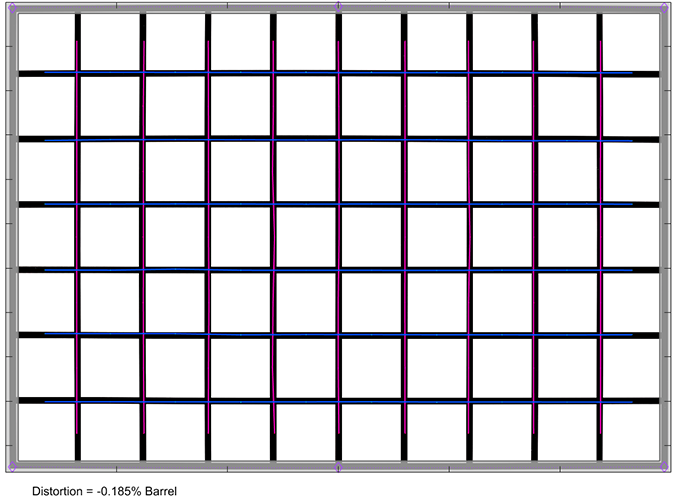

The RAW distortion characteristic of the Canon RF 100-500mm f/4.5-7.1 USM L IS is pretty good by today's mirrorless standards. At 100mm, images are essentially free of distortions. Beyond there's an increasing amount of pincushion distortions with a peak of ~1.6% at 500mm.
With activated image auto-correction, the distortions are very well corrected as you can see below.

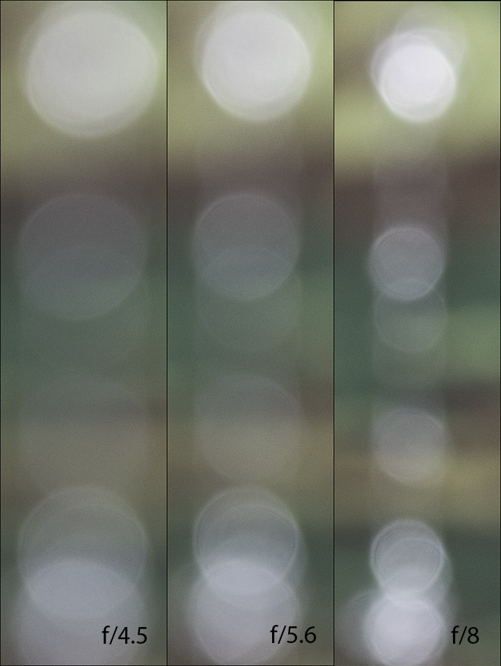

Super-tele zoom lenses tend to have a rather busy bokeh specifically with respect to the rendering of out of focus highlights. So how does the Canon RF 100-500mm f/4.5-7.1 USM L IS manage in this respect? It depends ...
Out-of-focus highlights are nicely rendered. The inner disc zone is pretty clean and there's just a slight outlining effect at the disc edges.
The shape of the highlights tends to deteriorate towards the image borders - this is due to mechanical vignetting. The Canon lens is also affected by this as you can see below. The disc in the dead center is perfectly circular but this changes from the mid-field. The corner discs are a bit irregular in shape but avoid edgy cat eyes at least. Stopping down corrects the shape towards a circular shape.
