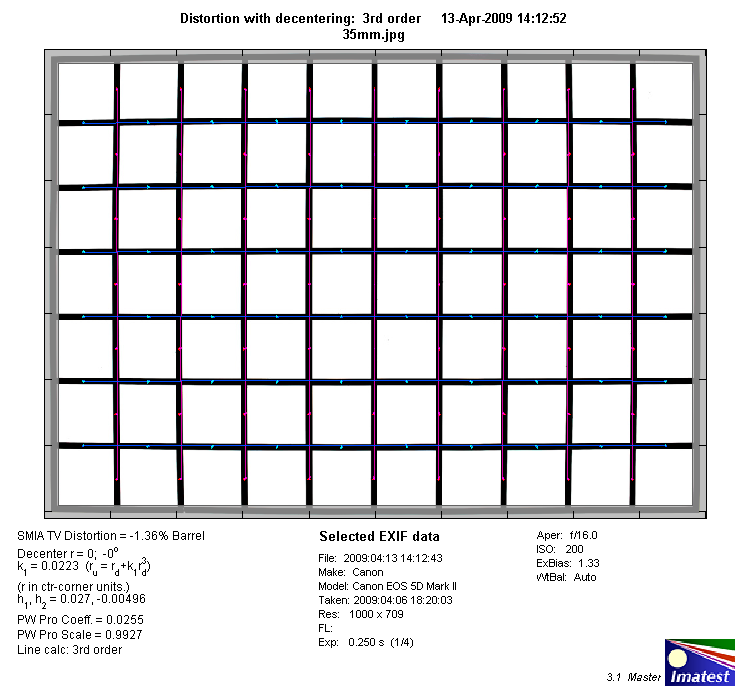

The lens shows only a moderate degree of barrel distortion (~1.4%) - this is not insignificant but it's usually not overly field-relevant either.

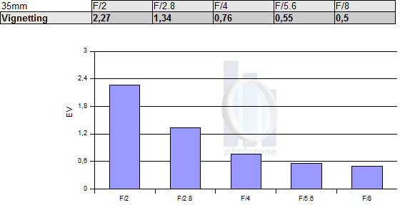

Vignetting is a major weakness of this lens - an edge deterioration of more than 2.2EV @ f/2 is massive and easily visible in most situations. The problem is reduced at f/2.8 but still not negligible. Vignetting is well controlled from about f/4 onwards but this is rather "late".

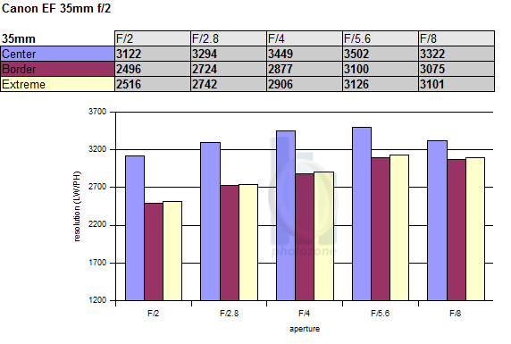

The lens showed a comparatively strong performance in the lab. The center is already very good at f/2 increasing to excellent resolution figures at medium aperture settings. The borders and corners are weaker (but still good) at f/2-f/2.8 but they do also increase their quality to very good level from f/4-f/8. The resolution peak is reached around f/5.6. It's quite interesting that the extreme corner quality is a tad higher than at the borders - an unusual characteristic here.

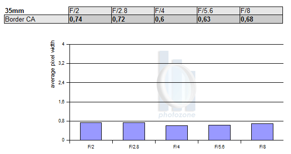

Lateral CAs (visible as color shadows at harsh contrast transitions) are no big issue with an average CA pixel width of around 0.7px at the image border throughout the tested aperture range.
