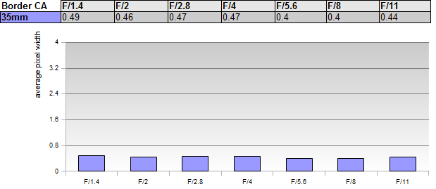

Chromatic aberrations (color shadows at harsh contrast transitions) are very well controlled showing readings below an average pixel width of 0.5px at the image borders.

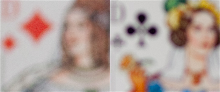

One of the primary usage scenarios for a large aperture lens is to seperate the main subject from the background. In such an image the quality of the bokeh (out-of-focus blur) is of major significance.
The lens generally delivers quite smooth bokeh for a wide angle prime but it is not perfect here. In our test scene below the Sigma shows a tad of nervousness in the focus transition zones - more so towards the more critical background.

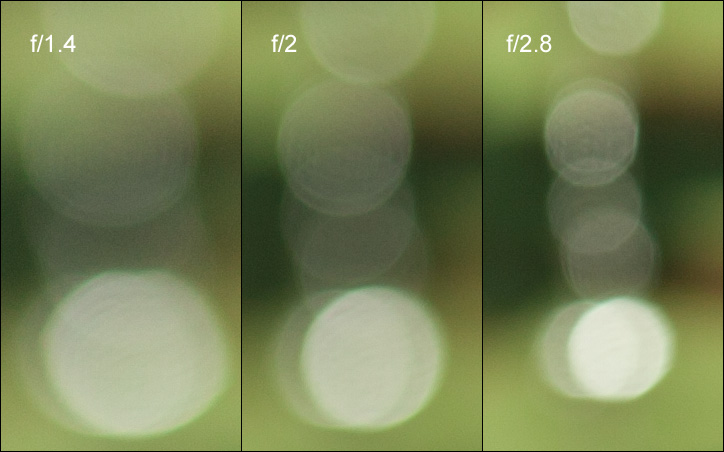

Thanks to 9 rounded aperture blades, background highlights retain their circular shape in the relevant aperture range, except towards the image corners, where they are cut off a little at one side due to mechanical vignetting. There is almost no outlining in the disks formed by highlights, but the discs show a slight onion-like substructure.

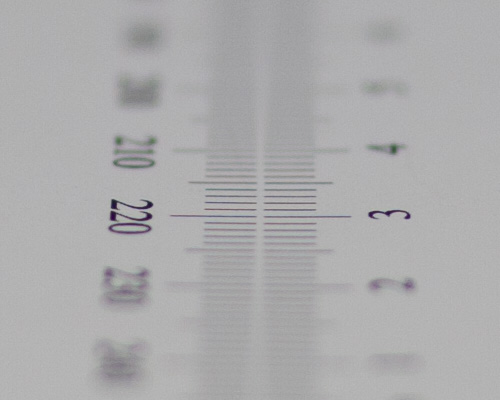

LoCAs (non-coinciding focal planes of the various colors) are a common issue with relatively fast glass. As you can notice below the halos have different colors - magenta (red + blue) in front of the focus point and green beyond. Truly "apochromatic" lenses don't show LoCAs but these lenses are very rare especially below 100mm. Unlike lateral CAs, LoCAs cannot easily be fixed in post processing.
Typical for most fast primes, especially ultra fast ones, the Sigma shows some amount of bokeh fringing at large aperture settings, which can of course be reduced by stopping down. The issue is mostly gone from f/2.8 onward.
In addition, these shots also illustrate that there is no focus shift when stopping down, as it was already mentioned in the MTF section.
f/1.4 f/2 f/2.8 f/4
