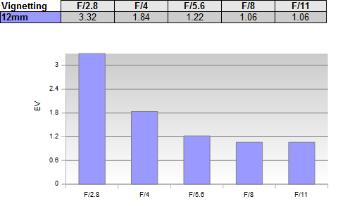

Very fast lenses suffer from pronounced vignetting at large apertures, and the Laowa lens is no exception to this rule here. Wide open, there is a hefty amount of light fall-off (3.3EV) towards the corners. However, to be fair - we have seen similar results from much longer focal lengths and ultra-wide lenses have a high degree of natural light falloff anyway. The vignetting is substantially reduced at f/4 and well controlled from f/5.6 onward (for such a lens).

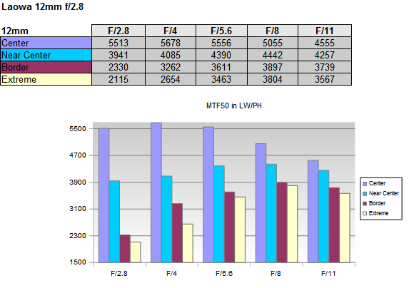

The 50mp sensor of the Canon EOS 5Ds R is a torture ground for many lenses so it's no surprise that the Laowa 12mm f/2.8 had some ups and downs here as well. The good news first - the center quality is superb even at f/2.8. The near center performance is pretty decent at f/2.8 and very good at medium aperture settings. The outer image region isn't all that hot at f/2.8 though. Stopping down to f/4 lifts the borders to good levels whereas the corners remain rather soft. There is, however, a substantial boost at f/5.6 with good results even in the image corners. The global peak performance is reached at f/8.
The field curvature is pronounced at f/2.8 and f/4 and it slowly dissolves beyond. The first sample we tested had a centering issue but please remember that we are talking about prototypes here. The 2nd sample was much better. It's worth noting that we were using a much bigger chart size than usual for this specific test (260x180cm) - this is still not perfect for testing such lenses but it improves the validity of the results.

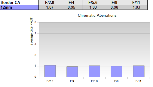

Chromatic aberrations (color shadows at harsh contrast transitions) are well controlled with readings around an average pixel width of 1px at the image borders. The CAs increase substantially in the extreme corners though.

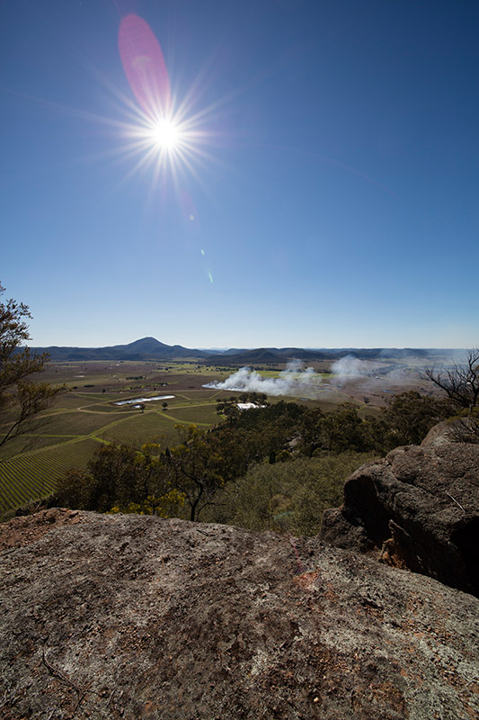

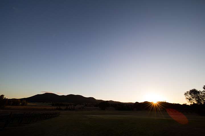

Ultra-wide lenses are often exposed to back-light due to their immense depth-of-field. Unfortunately the handling of spot light isn't a strength of the Laowa lens. You may spot some heavy ghostings in the images below. This is not unusual but we've seen better lenses here - namely the Canon EF 11-24mm f/4 USM L.
We had a chat about the topic with Laowa. It seems as if the issue is primarily showing up at closed aperture (here: f/8). They are investigating the issue now.
