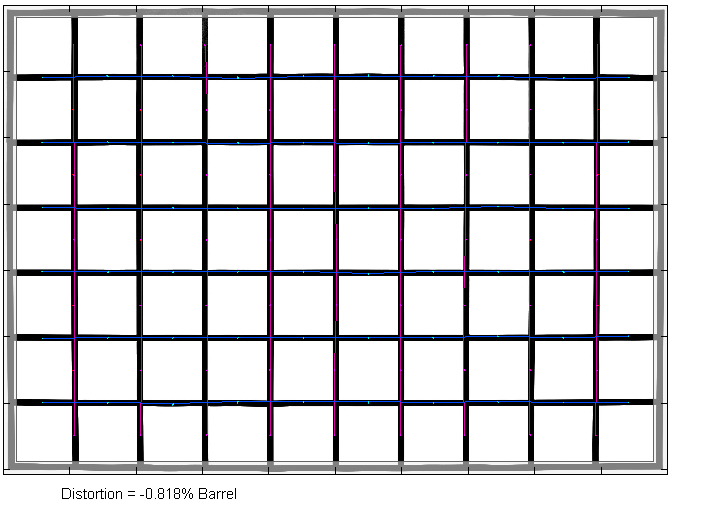

Just like its 32mm cousin, the Zeiss 12mm f/2.8 isn't totally corrected in terms of distortions. In untouched RAW files, it shows a barrel distortion of 2%. To be fair - this is certainly very moderate for such an ultra-wide angle lens. With activated auto-correction the issue decreases to a very slight 0.8% barrel distortion. This value may vary across different RAW converters since the lens profiles can differ.
If you move your mouse cursor over the image you can switch to the corresponding "raw" results.

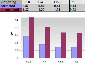

The auto-correction is also active for vignetting. Corrected JPEG images show a light falloff of 0.9EV (f-stops) at f/2.8. While this is visible in certain scenes, it is comparatively moderate for a lens in this class. As usual the vignetting decreases when stopping down and it's not really relevant anymore beyond f/4 (below 0.5EV).
Uncorrected RAWs show a very different story with a very high falloff of more than 1.8EV at max aperture and still 1.2EV at f/4. The issue is never really gone with just under 1EV at the best setting (f/8).

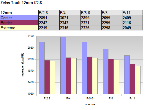

Ultra wide angle lenses are already difficult to design. The optical problems are then even magnified on mirrorless cameras with their short sensor to rear element distance in conjunction with recessed photodiodes on the sensor. Now keeping this in mind, the Zeiss Touit 12mm f/2.8 does a very good job in terms of resolution. The center quality is excellent straight from f/2.8 and it already peaks at f/4. The border and corner quality hovers a bit around the good to very good mark with the best results at f/5.6. It is worth to note that the good corner quality at max aperture is quite surprising. On the other hand, f/11 should be avoided due to the more pronounced diffraction effects.
The centering quality of tested sample was fairly good. The field curvature is quite low.
Please note that the results were obtained from uncorrected RAWs. The quality of the (distortion-)corrected images depends on the specific converter so we decided to avoid this discussion here.

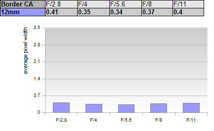

At around 0.4px lateral CAs (color shadows at hard contrast transitions) are very low and usually nothing to worry about.
