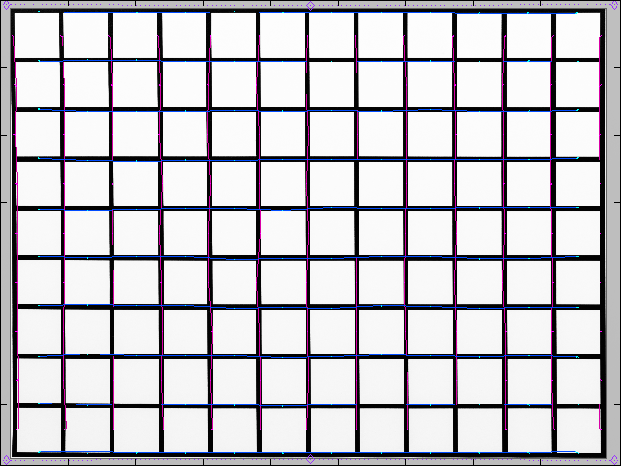

Macro lenses tend to have marginal image distortion. This is also true for the Olympus lens - it produces just slight pincushion distortion of 0.6%. This is also the original distortion as present in RAW files rather than an auto-corrected result.
0.6% Pincushion
