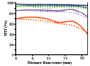

Here're some real MTFs ...
An outstanding performance - both in contrast and sharpness! |
