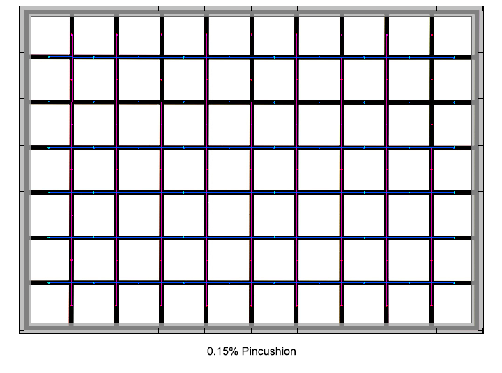

On DX, the Sonnar produces a tiny amount of pincushion distortion. At 0.15% it is so low that in practical terms the lens can be considered distortion-free.

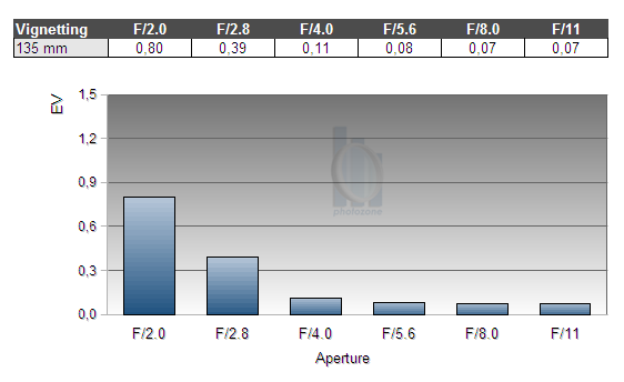

Since it is designed for the bigger area of a FX sensor, the Zeiss shows only moderate vignetting wide open, which as usual is reduced to lower numbers by stopping down. From f/4 onwards, light fall-off towards the corners is no longer noticeable.

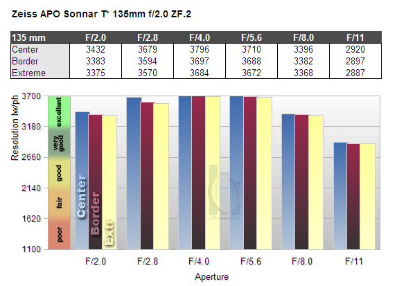

The resolution figures of the lens are stunning and on an exceptionally high level. Straight from the maximum aperture, the Sonnar delivers excellent resolution not only in the image center, but across the whole frame.
At smaller apertures the MTF numbers increase to even higher values. Theoretically the peak performance is reached at f/4. Practically, however, the sharpness is on such a high level at any aperture setting between f/2 and f/8 that there is no visible difference.

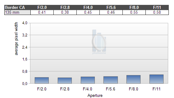

Lateral CAs (color shadows at harsh contrast transitions) are well controlled with low amounts of around 0.4 to 0.6 pixelsl on the average at the image borders.

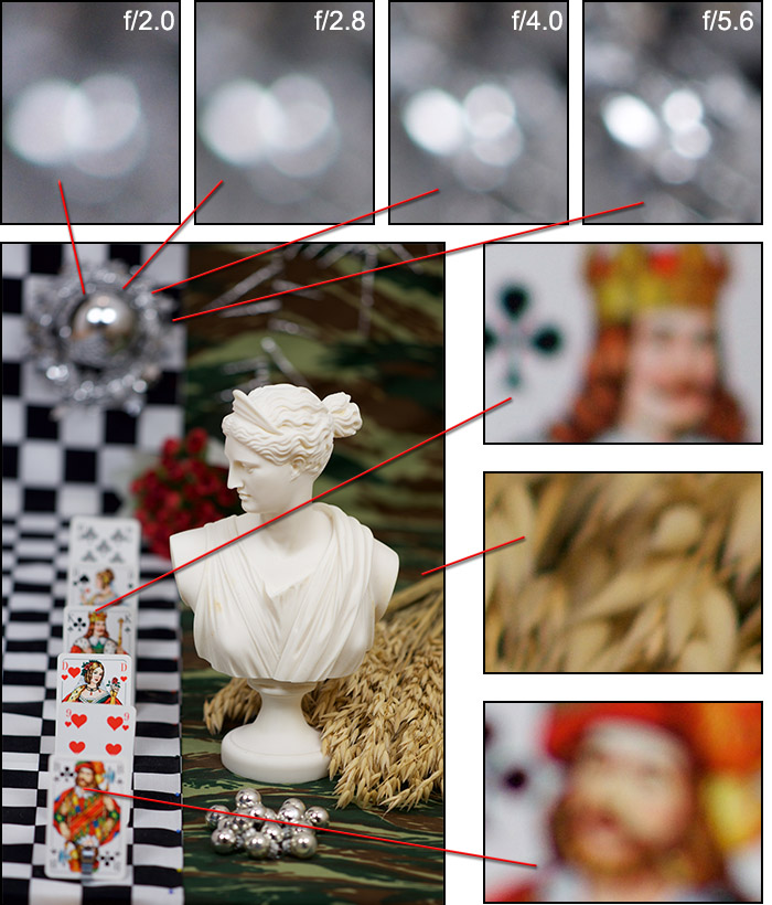

The lens not only delivers outstanding sharpness, it also combines it with very pleasant bokeh.
Image blur is very smooth both in front of as well as behind the focal plane. In addition, background highlights are evenly filled and show almost no outlining. Typical for such a fast lens however, the highlights show a little bit of a cat's eye shape at the image borders at large apertures due to mechanical vignetting.

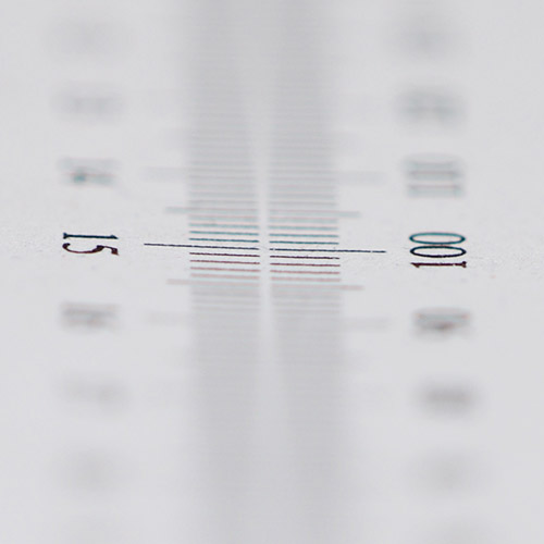

Bokeh Fringing
Bokeh fringing (non-coinciding focal planes of the various colors) is a common issue with relatively fast glass. It is usually visible as halos of different colors - magenta (red + blue) in front of the focus point and green beyond. Unlike lateral CAs, bokeh fringing cannot easily be fixed in post processing.
The Zeiss is an APO lens though, which means it corrects most of these colour shifts. As can be seen in the images below, there is only a minor amount of colour casts visible at f/2 that disappears completely by stopping down.
f/2 f/2.8 f/4 f/5.6 f/8.0
