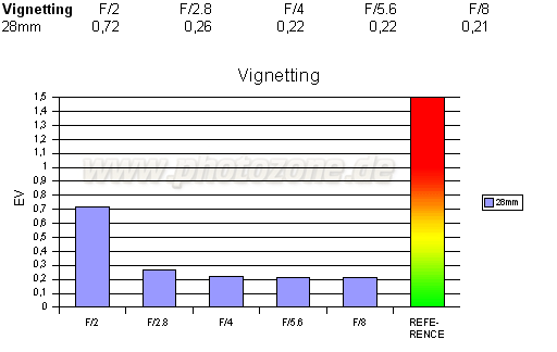

Nonetheless vignetting is still quite pronounced (~0.7EV) at wide open aperture
but from f/2.8 and up vignetting is no longer field-relevant.

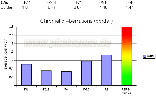

The degree of lateral chromatic aberrations (color shadows at harsh contrast transitions)
is a little mixed depending on the chosen aperture. From f/2 to f/4 CAs are quite low
and not really field-relevant. The problem increases at f/5.6 and more so at f/8 to
quite pronounced but not critical levels.
Please note that lateral CAs can be quite easily reduced or even removed via tools.
