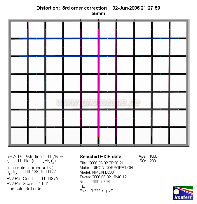

The AF-S 55-200mm DX provides distortion-free images at 55mm changing to rather pronounced pincushion distortion at 100mm (1.7%) and 200mm (1.5%).
55mm 100mm 200mm

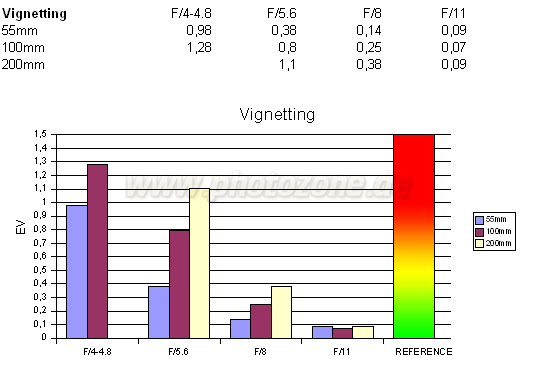

As mentioned the AF-S 55-200mm DX is a reduced image circle lens (APS-C) and typical for such lenses vignetting is more pronounced compared to classic full frame lenses. At wide-open aperture vignetting is quite high at around 1EV so it is advisable to stop down a little in critical situations.

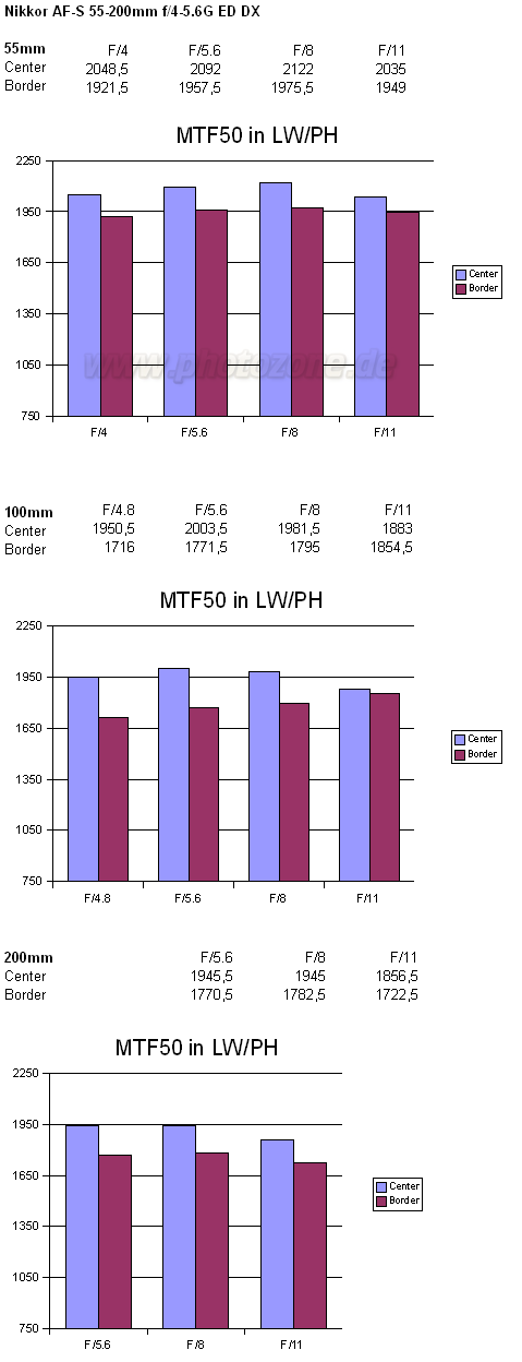

The Nikkor AF-S 55-200mm f/4-5.6 G ED DX showed a very good resolution characteristic in the lab. At 55mm the results are even on an excellent level both in the center as well as at the borders. The quality decreases slightly when zooming towards the long end of the zoom range but remains quite impressive. Nonetheless you may prefer to stop down a little at 200mm to improve the contrast quality (not formally measurable via the Imatest procedure).
The lens showed a slightly uneven resolution distribution (centering defect).

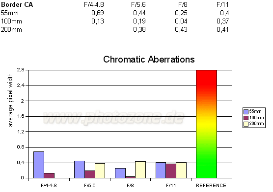

Lateral chromatic aberrations (color shadows at harsh contrast transitions) are very low throughout the zoom range and not field relevant by most standards. The lens appears to be free of purple fringing which is often a problem with legacy lenses.
