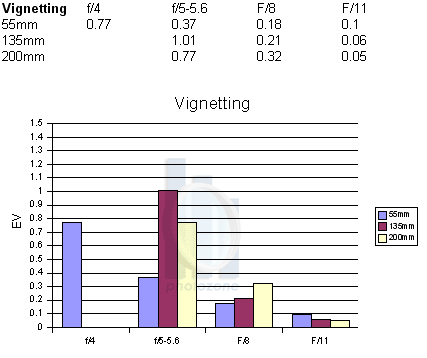

As mentioned the AF-S 55-200mm VR is a reduced image circle lens so it produces a comparatively higher degree of vignetting compared to classic full format lenses. However, the Nikkor does actually a quite good job. At 55mm and 200mm there's only a relatively moderate degree of vignetting (~0.77EV at wide-open aperture) whereas it is more pronounced at 135mm (1EV @ f/4). If you close the aperture by one f-stop the vignetting is already reduced to a negligible degree.
