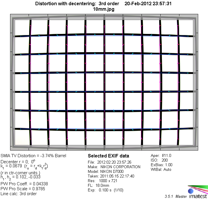

Super zoom lenses usually show quite pronounced image distortion and the Tamron 18-270 VC PZD is no exception in this regard. At the shortest setting there is very pronounced barrel distortion of just below 4%. When zooming in, the type of distortion soon flips over to the pincushion kind. At 35mm, it's already quite pronounced and reaches a maximum of more than 2.1% at 80mm. Zooming in further, the amount of distortion decreases a little, but remains on a rather high level, even for a super zoom.

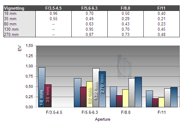

Vignetting is quite well controlled at medium focal lengths, but more pronounced at the shortest zoom setting and also from 130mm onwards. As usual, stopping down helps to decrease the amount of light fall-off.

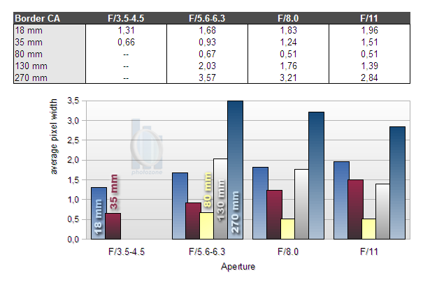

CAs (color shadows at harsh contrast transitions) are well controlled at medium focal lengths. At 18mm and 130mm they are more pronounced and reach very high values at the longest focal length setting of 270mm.
However, CAs can easily be corrected in software or by the camera itself (most modern Nikon DSLRs remove CAs themselves if you shoot JPGs).
