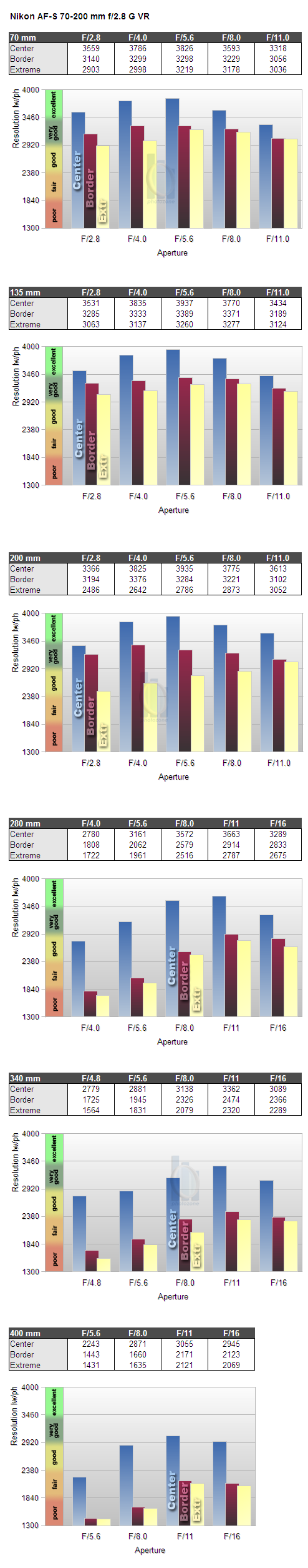

At 70 mm and 135 mm the center resolution is excellent wide open already and remains on this very high level until diffraction kicks in at f/11. At 200 mm the center resolution starts a little lower wide open, but sharpness is still very good here and excellent stopped down.
At all focal lengths the borders show very good sharpness at all tested apertures, the same applies to corner sharpness at 70 mm and 135 mm. At 200 mm though the lens shows only good resolution, unless stopped way down to f/11.
We also measured resolution with tele converters attached. The measurements were done with the lens set to 200 mm.
With the TC-14E II the center resolution is only good wide open, but already very good at f/5.6 and excellent beyond. The borders and corners are very soft wide open and at f/5.6, the lens needs to be stopped down to f/8 to reach good sharpness here.
The TC-17E II reduces sharpness a little more. Center resolution is good wide open and at f/5.6, very good at f/8 and beyond, but no longer reaches excellent levels. Border and corners are very soft wide open and at f/5.6. Stopped down to f/8 and beyond the resolution increases to fair levels, at f/11 the border just reaches good resolution.
With the TC-20E II attached resolution drops further, center sharpness is just fair wide open, good at f/8 and very good by f/11. Borders and corners show poor resolution wide open and at f/8 and just fair results at f/11 and f/16.
We're a little worried about the amount of sample variation we saw during the creation of this review. A total of 4 lenses were run through the complete test cycle, two of which showed resolution values significantly below what you see in these charts. Two additional lenses were so soft wide open that we stopped to review them after just a few test shots.
In all cases softness wide open seemed to be a result of misalignment of one of the elements, maybe the VR unit (but this is pure speculation on our side).
