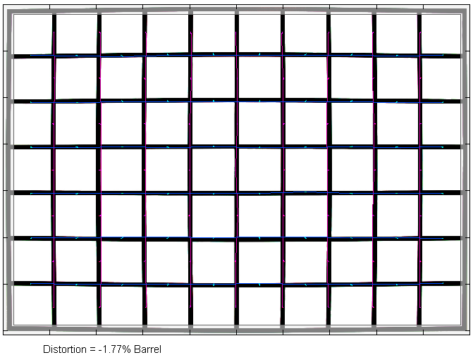

The Sigma lens produces a moderate amount of barrel distortion (~1.8%) which can be visible e.g. during architecture photography. However, it is certainly no show-stopper for most use-cases.

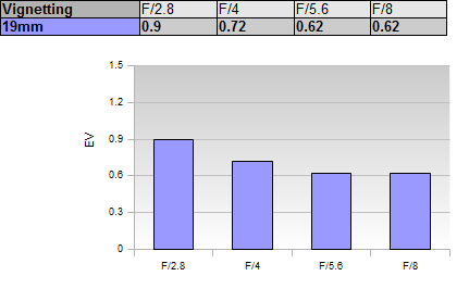

The light fall-off is comparatively heavy at f/2.8 (~0.9 f-stops) - this will be noticeable in some field images. Stopping down eases the issue a little bit it doesn't go away completely.

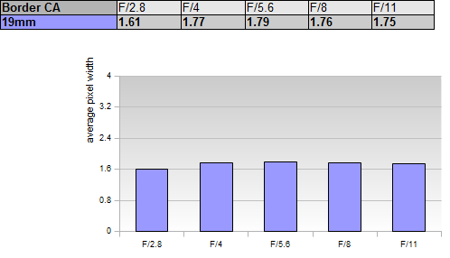

The Sigma lens produces a quite high amount of lateral CAs (color shadows at harsh contrast transitions) with an average pixel width of around ~1.7px at the image borders. This will be visible in certain scenes but remember that this can be corrected during image post-processing.
