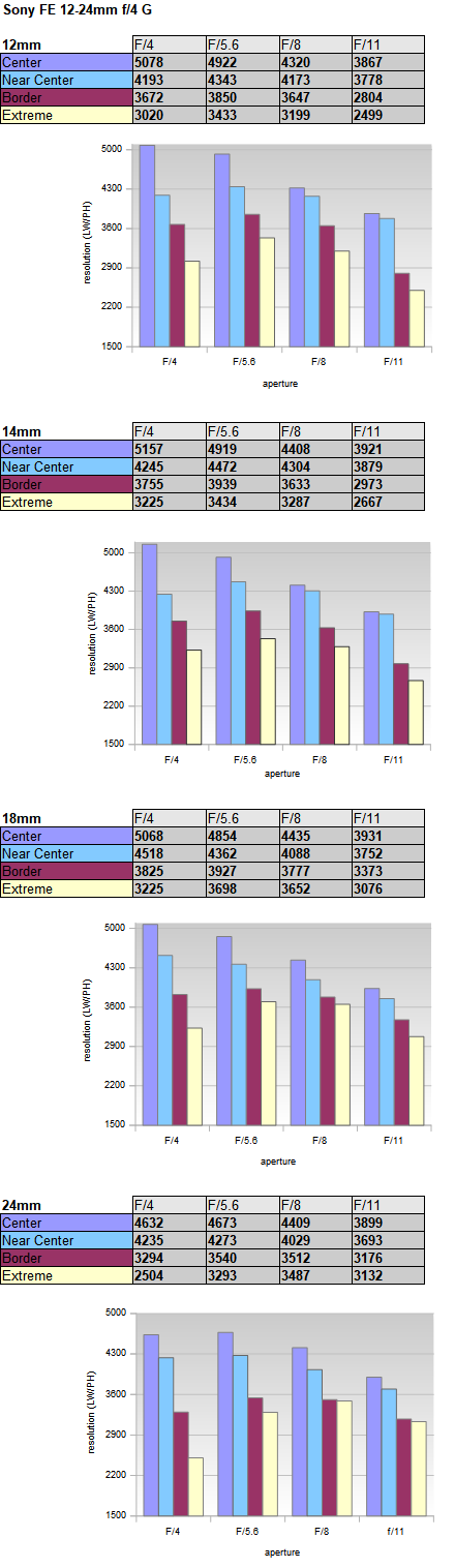

High resolution sensors tend to be challenging for many lenses especially in the ultra-wide segment but the Sony FE 12-24mm f/4 G is capable of delivering very decent results. The center quality is outstanding at 12mm and large aperture settings. The border quality is also very good and the corners are managing to stay at least on a good level. The most extreme corner (just beyond what we define as corner which is already far out) is a tad soft though. You should avoid small apertures unless really needed because diffraction has already a strong impact at f/11. The performance is similar at 14mm. The sweet spot of the lens is reached at 18mm where the corners are seeing a boost to very good levels (just). Traditionally the "long" end is the weakest spot in an ultra-wide zoom lens. While the performance is somewhat reduced in this case, it remains on a quite high level from f/5.6 onward at least.
The centering quality of the tested sample was very good.
