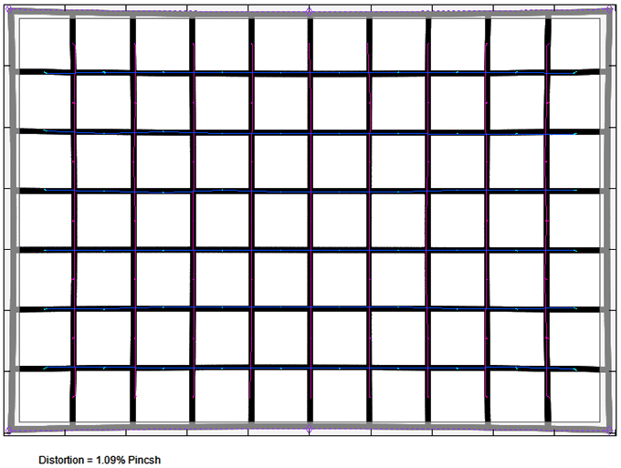

If you rely on Sony's image auto-correction algorithms, there's little to worry about in terms of distortions. A maximum of 0.6% barrel distortion at 16mm may be just noticeable but it's far from disturbing.
The native characteristic of the lens is, of course, worse albeit not excessive for a lens in this class. At 16mm there is a heavy barrel distortion of ~4.2%. This is reduced to a moderate degree at 20mm and the Sony lens is pretty much free of distortions at 24mm. From there, the distortion characteristic switches to pincushion type reaching a moderate 1.3% at 35mm.
